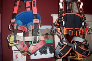

A few nice design changes, some good stuff lost though, I guess it always takes time to get used to something new.

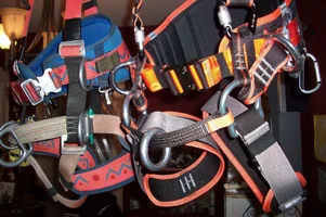

...even though I don't like the new leg buckles(you have to step through each leg loop to put on), and the handsaw snap is missing, I'll have to let those things pass as I've found this to be the most comfortable work positioning harness EVER! Ergonomic, efficient weight distribution, no pinching, lightweight yet no nonsense heavy duty construction.
