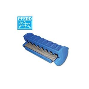

Just wondering how often everyone is lubing up your tips..on your bars that is. Also anyone got one of those bar files and or a bar rail closer. Are they worth having? I usually just use a large flat file to take down the edges and the burrs and have never closed a bar rail yet.

Flat file works for getting the burr off but it won't straighten the rails. If the rails are worn or bent the chain will wobble instead of being held square to the bar. This leads to chain and bar wear and will likely cause bad cuts too.

You can close the rails manually if you're careful. Slip a short piece of chain in the bar. Lay it on an anvil and gently peen the rails...gently...you're doing machinist work not blacksmithing. Peen the rails until the chain glides smooth and square. This isn't easy to do by hand.
The bar dressers are great for taking the burs off and dressing the bars. As far as the tip lubing goes. I was told by a wise mine that you can either not do it at all or you lube it all the time. There is no in between from what he said and he's like an encyclopedia of arboriculture knowledge.

I've closed the rails on a number of bars. Before straightening there was a certain sound from the saw. After doing a complete bar dressing the sound was much more pleasant. Hard to describe the difference. and the saws cut better too.

As far as dressing a bar goes,, it important to keep the rails level, and burs removed. Using a bar rail closer is a stop gap, as all it does is squeeze the outer rail together. The groove won't be the same width throughout its depth. The tool is also quite hard to use. I have one, only tried it a couple times. This tool is great for squaring up the rails, and removing burs.
