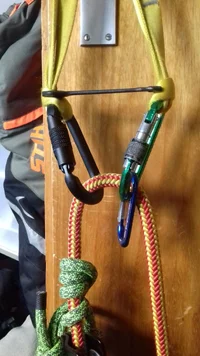

@DSMc I agree about not needing them very often, what I do need often is one that can be retrieved once I'm on the ground. This obviously works better with a basetie. If I can't use a natural redirect, I use a sling with two carabiners, and clip a small accessory biner on the retrieval side through the biner and around the rope. Basically a ring and ring, but midline attachable.

@climbstihl any way you could post a pic of that or sketch it? Not visualizing it fully but like the idea of midline attaching and retrieving with a sling and biners. Nice to utilize the extras one usually has on their saddle.
@Serf Life Sure, here is a pic that should get it across. The door handle is the redirect limb, the friction hitch is where you would be, the right leg is going to your anchor. The wrench is just in there to separate the biners so you can see what's going on. To retrieve, just tie an overhand knot in the end (HMS carabiner recommended for easier retrieval with thick lines like my 12mm) or use a retriaval ball that won't fit through the accesory carabiner.
I would've done it outside in a tree, but the wind is blowing really 20190309_172602.webphard here.
I would've done it outside in a tree, but the wind is blowing really View attachment 57969hard here.
If you do the same thing with a Petzl Rollclip on one side and a Pinto Pulley on the other side it works even better and has almost zero friction on the retrieve. For the retrieve you use a wiregate microbiner or a little plastic ball that will pass through the Rollclip and catch on the Pinto. I forget who it was that put this one out there. It is on Youtube somewhere.

Yeah, it is a bit more spendy than just a couple of biners. But the lack of friction does make a difference if you go through several redirects after passing through the retrievable top anchor. Not something most of us do very often, but it is something to think about.
This works best as a retrievable top canopy anchor where you are going from a basal anchor, up to the retrievable anchor and then through one or more redirects. That is where the friction can really add up if you have multiple redirects.
Also, I forgot to point out that the set-up illustrated in the picture is so that you can climb on one side (the butterfly jams against the pinto) and retrieve it from the ground.

I was just thinking of that but with the accessory biner tethered to the rest of the setup. I might like the untethered way better.
Hadn't thought of that, I keep a short length of accessory cord with an accessory biner on my harness anyway for retrieving cinched slings with a biner like a pulleysaver. That could actually used as a retrievable redirect of your basetie on a featureless limb if I think about it.
