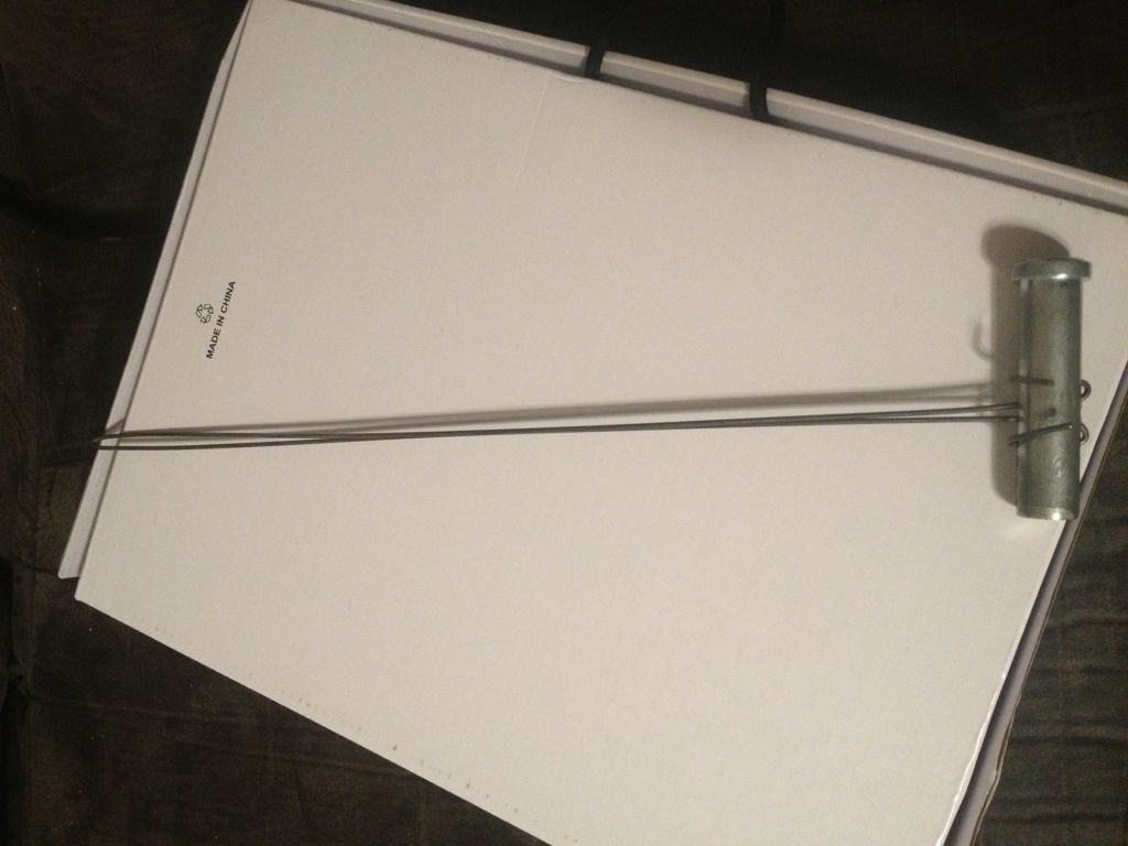

Wire fid works best. You can make your own for about $6 at a hardware store. [image]http://
[/image]
Yeah...what fid are you using?

I was trying to use a push fid (Selma). But will construct a wire fid out of 2.5mm high tensile fencing wire. The KY sounds like a good idea I was going to ask whether neat dish washing liquid would be appropriate to lubricate with but will get some KY as you recommend. I will take some snaps as I proceed and post. Thanks for the tips as I have read all the potential issues that you list and knew it wasn't going to be easy for a first time around.

For what it is worth the advice to use the wire fid is best.
Just put a tight eye splice in my partners used Tachyon and I couldn't get it to happen with a standard fid, Toss wand was brutal and broke a vectran braided loop I had made, and the wire fid worked on the first try :-)
