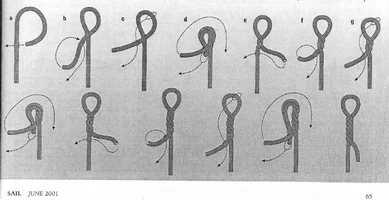

I'll play unofficial archivist for a minute
Here's two attachments nick posted at the treehouse that show instructions I believe by Brion Toss for a locked brummel (nick can clarify I'm sure).
jp
Here's the instructions that go with the image. I use the measurements nick recommended and follow these instructions for doing the beeline (or HRC) splice.
jp
