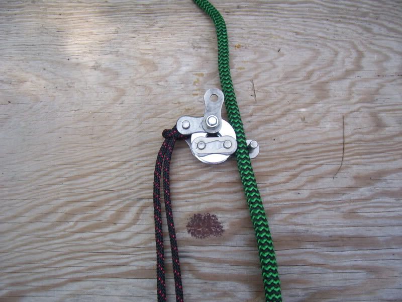

So now that I done drunk the treebuzz SRT RopeWrench working kool-aid, I have 2 climbing ropes with spliced eyes on the end. I never use the eyes any more except to sometimes pull the line into the tree with the throwline. I can only thread the RW onto the end with no eye on it of course, which makes me have to think about which way the rope goes up into the tree. I seems like it would be nicer to have no spliced eyes at all, but maybe I'm missing something.
My question: Am I missing out on some use of the spliced eye with SRT? Or should I cut off the end of one of the climbing lines and turn it into a lanyard? Hmmmm.

Or you modify your wrench with a 5/16 X1 inch quick release pin available at west marine or you local rope wrench dealer soon. $20. Easy and functional fix.
ah yes i had noted the rope wrench midline mod and am quite interested. I even looked up the west marine part! I may be placing an order with a rope wrench dealer quite soon!!
but was there some concern that having the quick release pin would make it harder to adjust the friction? I can't quite see how it would, but someone mentioned that in a previous thread.

You lose a little on the way skinnier styles of rope but it is just about right for poison ivy tachyon, velocity, and the 16 strands.
Oh, ok - i get it. the quick release pin is just a little skinnier than what it replaces. my long hands won't ever climb any ropes skinner than tachyon, so I'm into the midline dream and the quick release pin.
