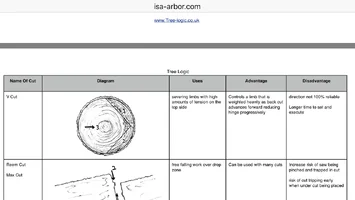

"Shigo V-Cut"??
Folks use that term for a specific pattern of utility line clearance for trees growing directly beneath the wires. So the "V" is that opening in the crown, with branches left on either side growing above and beyond the wires. Alex didn't really like that style much, but he does show it as "correct" on pages 21 and 28 of the "little yellow book" ("Pruning Trees Near Electric Utility Lines"). It does provide the compromise of having large-ish trees beneath utility lines without tipping/topping/roundovers. Alex's usual preference was to have only small trees or no trees directly beneath lines...or have the utilities buried (which poses its own problems).
The transition from roundover pruning has been painful. utilities used to do more of a "U-Cut", clearing only a short distance below the wires. Then some began to deep-dive, taking off branches way below the lines, and even below the bundle of communications wires. This results in huge wounds, imbalance, and
high risk, which are worsened after sprouts are removed on the next visit.
I'm trying to encourage a return to U-cutting, and directional pruning on the regrowth. The pushback is fierce, but no one can tell me why V-cutting way beyond clearance limits (MVD) is necessary, or even desirable. I'm afraid that Alex might be spinning cartwheels if he saw cuts like this made in his name!
