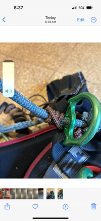

I fiddled with adjustable bridges in my early days and it just seemed pointless. Fiddled again a couple years later and it still didn’t seem right. Decided to try again after looking at the Kinisi but I couldn’t get over the fact you can’t let it out under load. Tom Dunlap enlightened me about its usage coming back from a limb walk, but I literally only use it to ascend and for awkward close position situations. I think there’s a saddle that uses the same idea but nobody uses that saddle lol. Had great success with it the past few days tho!
