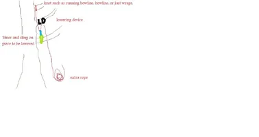

As an alternative to a remote release, someone posted an idea for being able to lower limbs and release from above.
The jist of it is to use webbing slings and 'biners, placing a lowering device or wrap on trunk/ limb near the work area, allowing a bight to droop down, then back up to an accessible-to-the-climber, higher-than-the-workpiece-height, and tie off with a knot of choice. Then, cut the piece, lower to ground on the bight, untie the knot to drop the rope, and pull the rope through the 'biner. It will release every time, without a fuss. After you lower the pieces you need to remove, you descend and remove the slings/'biners.
You will need a rope that is double you height in the tree, slings and biners, and a lowering device (or wraps).
Man, that is so simple why didn't I firgure that out. Same strength loss as a knot at the attachment. Thanks Sean. Hey Ron what did you cut that piece with? Looks like a swede saw.

Looks like a good system. Looks like if you're crafty, well-set-up, and maybe having a few tweaks, you can safely catch appropriate, dynamic loads relatively safely, too.
I'm just passing on an idea that I had never worked out on my own, that I read on the Buzz.
Thanks, Buzzers.
