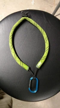

Neck tether. Just took the core out of some armorprus. Replaced with black bungy and put a dmm shadow on it. The key for me was to find how long I needed my armor prus sheath to be vs the bungy. Never once had it catch. Never once have I had a problem where it felt tight... as far as the asphyxiation idea goes... prolly not possible actually. If you were to pass out, only way it would be able to strangle you is if you went forward.... however given the location of our equipment etc, passing out forward is pretty well nigh impossible. Instead you would slide off sideways or backwards putting pressure on the back of your neck. Not once have I ever been worried about it. Been rocking one about 3 years
