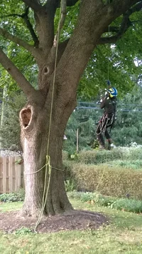

Here is my minimalist lowerable basal tie off system. It requires a long rope, but nothing else. I've been using it for a while now, and the guys at work have lowered me in different scenarios (multiple unions, single union smooth bark, etc.) works well.
Key features: It uses the tail of your climbing line, with an alpine butterfly and a blakes hitch. You need enough extra rope to be lowered 3x to your TIP. The blakes hitch is backed up with a slip knot so even if it jams into it, it can still be released. The slip knot is backed up with a half hitch (could be backed up with a biner, i use the half hitch to continue with the minimalist trend.) You can simple take a trunk wrap with the rope beneath the blakes If more friction is needed to allow the blakes to lower smoothly.

That's what I use on my 9 year old son. He has times where he can't pull off a weight transfer cause he's to close to the tip and to far from a branch to which he can switch over to descend. What I do different is I use a biner in the tail of the Blake's clipped to the slip knot.
I am also a gear junkie, but I really like this gearless system! Just don't ever forget the stopper knot below the Blake's Hitch. That way if you drop a limb and it slides down the rope onto the hitch you won't take a ride.
Try it another way.
Before you tie off walk four times around the base of the tree with the rope. Than tie off.
ICE your groundie can untie. Walk around the tree untill you get lowered. Look at the tree as a big portawrap.
The 4 walk around, alpine butterfly, and carabiner has been my go to choice recently. I have an easier time trusting my groundie with that setup than any other.
