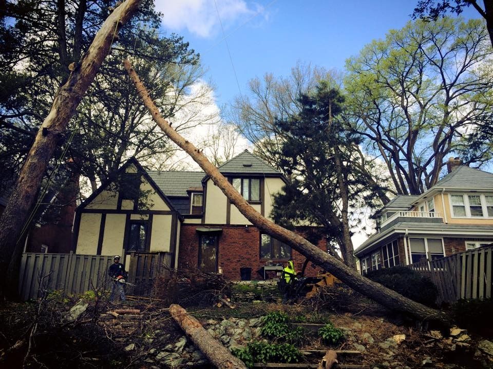

oh shoot! another thread to be a part of. Great subject. I've done this maybe 10 to 12 times in my career I think. This can easily generate some of the most extreme forces. I think it's more touchy then big weight speedlining actually. Seriously. This stuff needs thought out very well or stuff can go bad bigtime.
Lots of stuff to prepare for and watch out for. Butts of logs WILL tear away from the hingewood on a stump on heavy, tall trees. just as you get lower than 45 degrees.
I have lots of footage of various jobs and planned on doing a video on this of course.
I'll do some diagrams and show some still pictures for now I guess. This week I think.
But just a quick bit of info, if I'm worried about a butt ripping off the hinge wood and spearing back, I attach it to the stump. with chain in cut grooves or large diam rope, or I've done both.
