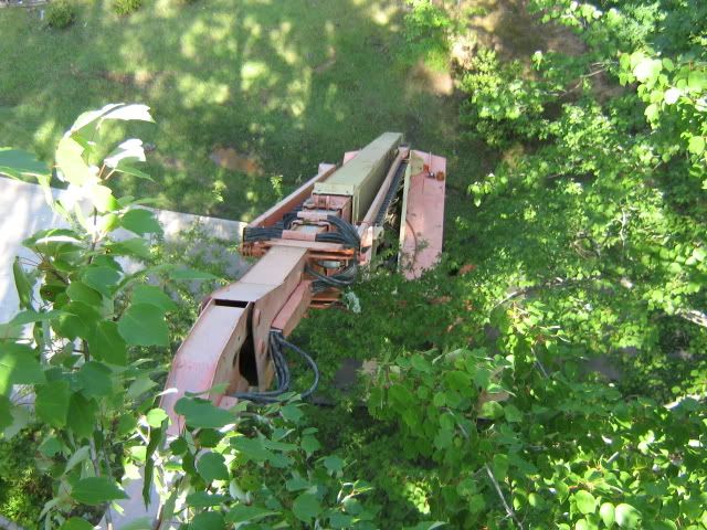

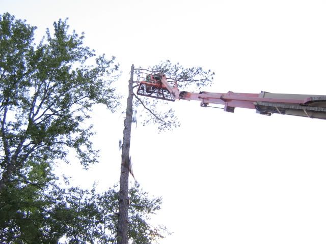

Yeah the 120' I used weighed 46klbs and could put 26klbs on one tire. There is no problem driving at full extention, the problem comes from not inspecting the ground for hazards or changing conditions.
60'+/- of outreach, depending on the weight.
