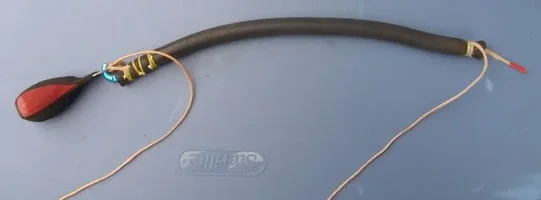

This is what I call my 'Little Shot' for using in-tree. Just a cut-off end of a key chain carabiner secured with some constrictor hitches using throwline.
I think the skinny line is Dyneema. Check out kite supply companies for the little line.
To girth hitch the throwbag to the small stuff I tied a mouse ear sized loop so that I can grip it with gloves on.
View attachment 37107 View attachment 37108

Think of this as a sort of bow and arrow setup. The tubing takes the place of the bow.
The throwbag is hooked over the cutoff biner and pulled back like an arrow. The other end of the throwline is tied onto the end of the old Big Shot tubing. Pull and release. It has about a 30' horizontal range.

When I first configured the Little Shot I was concerned that I would whack my left hand that was holding the end of the tubing. I never have...knock on wood! I do try to keep my left hand down a little. think of where your hand is on the Y of a Wrist Rocket or slingshot just to be a little out of the line of fire.
At first I thought the rubber acted like a stick to get over nubs and such, but I like the "little shot" concept. I'll have to try it. I've been setting my TIP lower and advancing it as needed to save time getting in the tree. I DDRT, so I like to get the perfect TIP; but that takes way tooooo long, especially on Mondays
