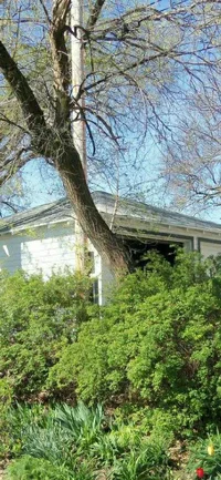

Can't really see in this pic how bad this elm was leaning, but the base was coming out from under the driveway slab at the top of the slope. The loader had cut through all the roots on that side, so the tree was pretty wiggly and most of it was dead. It was badly storm damaged, and had been topped at some point in the past. Lot's of garden targets, shed, etc. so getting it out of there was a pain in the ass, even though it wasn't very big. Bunch of it was right into the utility lines. Nothing in the tree or immediate vicinity to tie a climb line into, so I took it all out on spurs and a lanyard. Only took one afternoon, but when I was done hauling it away I went to the bar. The stress from being nervous about the whole thing collapsing underneath me took a toll on me, I can tell you.
