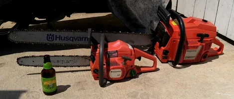

Bought one last month or so and it's the XP model, don't know if it is different from older ones. Doesn't look any different. I live in Ontario, Canada.
Picked up one off of Ebay, it's only a stumper, and large stem dropper. 36" 42" and 60" came with it.

I have the Euro model Chris....apparently much less of a rev limiter on it than the American model, which having heard a new one one sounds very sluggish.
I went one better again this week and had it modded at a specialist here in Victoria: http://www.walkerpowerequipment.com/
Boy you want to feel the response and torque on that sucker now. This is the 3rd saw they've done for me along with the 390 and 201....changes the game altogether. Delighted with the service and result. They get lots of stuff sent from the US and Europe, so if you do get stuck with the new model then all is not lost whether you have Donny or someone of similar time-served to carry out the work.

Nice MUF MOD!! how much for the muff, how things in BC? Hope your takin it easy on them out there!
Muffler, ignition timing and cylinder porting is about $175 or less I believe. Cost off mine is tied in with other things so I couldn't tell you exactly.
