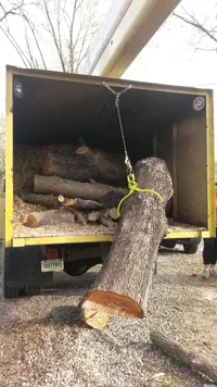

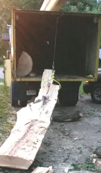

Here's a couple of pics of what I've been using lately. I've got a winch mounted to the front of my chip box, and a pulley at the back of it for lifting the wood. It's not a perfect solution, but it has saved me a lot of work.

I like your setup. I've been thinking about a winch for the front of my trailer. I have pulled some big logs up my ramps with my fiddle block, but a winch would be better for that.
Are you a one man show? Do you haul all of your logs in your chipper truck?

Some days I'm a one man outfit, but most days my wife helps me on the ground.
