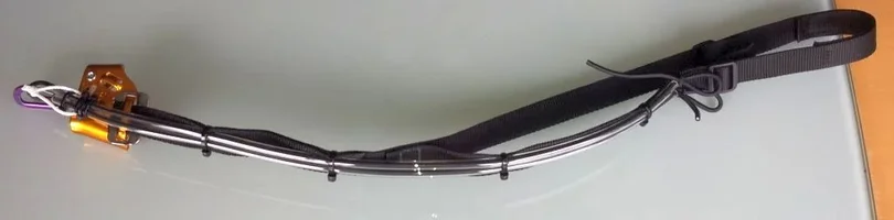

Yesterday I was out for climbing and I had forgotten a bungee of my knee ascender (see picture). I decided to integrate the bungee like it is the case for the HAAS and the SAKA that this cannot happen again.
The core innovation of the HAAS and the SAKA is that the bungee runs inside a pipe and is therefore longer at it seems to be. For the SAKA @yoyoman has spent two of this pipes which is indeed very clever because this doubles the force of the bungee without the disadvantage that they can twist.

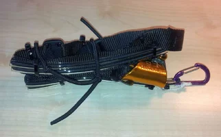

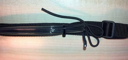

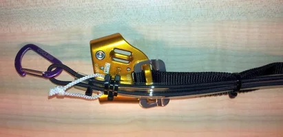

Sometimes I am a little bit lazy and that's why I came up with the following SAKA light version. It is based on the formally shown version of my Pantin / Footape combination and I added two tubings of polyurethane (it is softer than PE) with zip ties. Effort for the modificatin was about 15 minutes.
SAKA light-complete.webp SAKA light-size Biner.webp SAKA light-Pantin.webp SAKA light-Slip-Stopper-Knots.webp
Suggestions for improvement are welcome (if they follow the KISS principle).

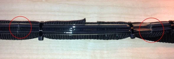

As shown in the former post it can be coiled to a small package. But that's not the best for the tubing and therefore I have cut the tubing in pieces of about 5" length. Now it can be folded into a small package without deforming the tubing. This A similar technique is sometimes used for tent-poles.
For the moment I am very pleased with my selfmade knee-ascender :rock:
Edit: ultralight means 145 g (0.32 lbs) in this case
Edit2: After some tests I went back to the "uncutted" version of the tubing because every cut created additional friction for the bungee cord. If the tubing consist in one piece than it runs much smoother. Sorry for that.

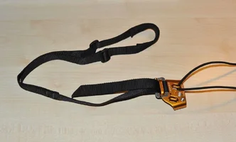

Here is what I came up with. I had an older Petzl basic sitting around and I made up a foot strap and a connection piece for the ascender. The webbing is your standard MIL SPEC tubular and the buckle is an AustriAlpin Cobra Frame, add a piece of heavy shock cord and a mini DMM biner and WA LAH. With a foot ascender on one foot and this on the other you can get up in the tree pretty easily.
