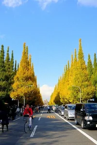

Jeff, do you mean like this? if so, the answer is yes it would seem.
