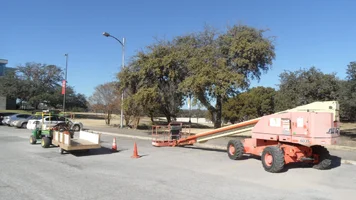

When I worked in Austin the campus had a 60' JLG lift
The lift worked great for me...but I was on a college campus so I could drive it from its parking spot to anywhere on campus. Also, I could park it far enough away from the root plate that I wasn't concerned with soil compaction of the root plate. If the soil was wet in one place I'd work in another or do something else. So, for this work zone it was great.
In a typical residential setting it would do the work but access might be an issue.
I set a personal standard not to cut away any good limbs so that I could thread the snorkel in to work. IN three years I only cut two live limbs for my convenience. Both were about 2" diameter and six feet long in 250 year old large, live oaks. MOst of the time I could thread my way in and ben limbs if I needed to.
You might find a small community near the lift company and coordinate access in a park for a demo. The perfect setup might be able to find a large tree in a parking lot island. then you can fake-up a workzone like you experience. Caution tape and cones would take the place of infrastructure that you'd have to work around. Lift-gator and trailer.webp
