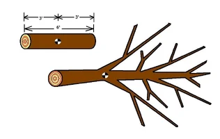

I think your logic is right on. It will be helpful. However, I am a visual learner and I had to draw it out to conceptualize it.
I hope this helps.
