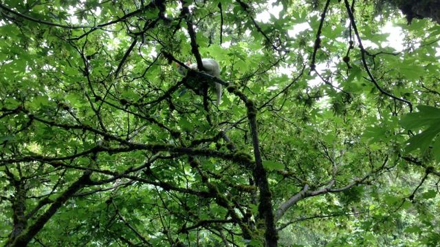

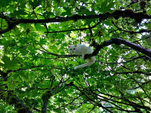

I used two lanyards (plus my main line in a neighboring tree) last week on this cat rescue. The cat was up 3 days in the rain, a busy street was 50' below, and there were power lines near and thru the tree. The branches were covered in wet moss, and there were no good TIPs overhead. I got as far as I could, and still had to use a 6' ketch pole.
All three ropes are very different colors, as well as the snaps. I use stuff sacks for the lanyards, and actually practice with them all, cuz it can get pretty confusing.
Regular lanyard with HC pulley
and a long CELanyard with a cambium saver that fits into a thowline bag.
Works for me.
