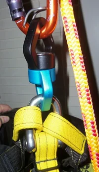

Jeff, I'd like to hear your opinion of the Yellow Jacket when you get a chance. Which link option did you choose?
I tried all of these, but didn't like any of them...
So, I tried this 1/2" stainless steel D link... perfect!
This is not the swivel I'm going to use with it, it was just handy when I was messing with the harness...
Weather is nice here, for a change, so I'll get over to the "test tree" tomorrow and try the saddle out. Haven't had a chance to do that, yet.
Rather big and clumsy, worked best small end down, but jammed all the loops together... flopped about a lot going from weighted harness to unweighted. Delta was even more annoying. The D shackle is sweet. Bottom (leg) loop stays on the pin, the belt loops stay on the sides, leaving the curved end for the 'biner, swivel, whatever. It stays in this configuration very well, weighted or not. It's larger diameter steel than the 3/8" pear/delta/quick links, but it's not as big, so weight is about the same.
I'm going to order one of the small Rock Exotica or DMM swivels to use on it. Otherwise, the carabiner is oriented in the wrong plane and that bothered me, too. Swivel takes care of that issue. Of course, so would a twist link.
