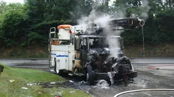

Funny you should mention this. Last Friday our fire company went out on a truck fire. It turned out to be a utility bucket. The crew said that they had just got down from the aerial and pulled the truck off the road to pick up signage and poof. With these two incidents in mind... What would you do if your bucket caught on fire while you were aloft? Jump? From full working height? Sit it out and hope the fire co gets there before the boom collapses? Or do you carry a bail out kit of some sort? What is it? These are all questions I have asked myself since last Friday. What is everyone doing out there (besides praying their truck doesn't catch fire).
