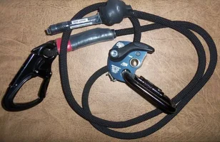

The Trango Cinch is the best thing I've found. It works a lot differently than other adjusters, so takes a bit of fiddling with it to figure out how it works (you can adjust it while weighted, using either the lever or by tipping the body to let out slack, or pull on tail go move in like other devices). Cleans up with solvents. Adjustable while weighted and works in pine pitch are its real claims to fame. I have a Zillon, too... but I don't use it in pine trees. It works fine, but I don't like having to clean that one up afterwards. Cinch works best on 10mm Beeline or Armorprus lanyard, or any 11mm doublebraid / kernmantle rope lanyard.
Short lanyard I use on right side of harness... Cinch on 11mm SuperStatic... pic taken when I made it. Some people like it on left side, use their thumb to flip lever up so you can pull back to adjust. I like it on the right side, so I can grab the lever with first 3 fingers and pull it up and back. You can also rotate the body forward to release it, but using the lever is much smoother and gives finer control. I think they sell for about $75 if I remember correctly.
