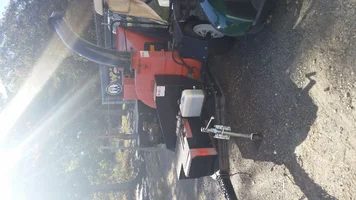

May be buying one of these. Just curious if anybody knows or has used one of these units before. I know not to expect much bein g its only a 9 inch 30 hp machine. Any info or opinions would be appreciated thanks fellers!
Ahhh cmon really!? . Youve used one before? I was hoping itd be a bit better givin, its got a diesel engin in it. Ace power is sellin it for a fair price. Im defntly guna give her a good test run first though
