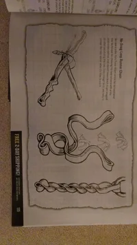

I learned a way of racking loops from a rock climbing forum a long time ago. Sometimes I do use daisy chains though.
Lets see if I can describe the method.
Start by clipping the loop into a biner. Then half the loop, give it a twist and put the end in the biner. Now you'll have two, half-length loops on the biner.
Consider the biner end noon and hook your thumb through the two loops at six o'clock.
Give a couple of twists or so. Enough to tighten the half-loops.
Next, drop the 'eye' where your thumb is over the biner.
This whole works won't look as tidy as a daisy chain. It is easier to tie, is more compact and shorter than a daisy chained sling and falls apart easily.

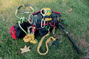

I keep all my runners and redirect/canopy anchor stuff in this New Tribe bag, just reach in and grab when I need something. Leave the most frequently used on the top. I put a bit of cord across the top so stuff doesn't fall out when squeezing through tight spots. The bag installs nicely on the TM harness.
Yep! That's what I do...(if packing for space!) I admit... I noose if I have time!
But for on site quickness, daisy chain all day long!
+! You can keep the unneeded cord daisy chained by re clipping the last bite left
Thats interesting, for me the noose is allot quicker than a daisy chain.

What have you found to be the most efficient way to attach a handful of slings to your saddle and minimize opportunities for them to snag on branches, etc.
I have been taking them, twisting them as a group as many times as I can, then using a carabiner to clip the two ends together, making a ball. This tends to make it a pain to separate them when needed.

I roll mine and then feed the end through the center a few times...kind of like a rope coil. They stay nice and tight and don't catch on much, but this method might not be super if you want to pile a ton of them on your sadle. I usually only have one or two on me...unless I know I will need more.
I like that method as well. Very tidy. I do the same. I don't have more than 3. If I need more, it usually means I'm going to be parked for a bit and will send down for a full rigging kit. I'm trying to get down to bare necessities and have a secondary bundle for bigger blocks etc. my saddle belt straps don't stay cinched if I have too much weight. Add a saw, a big block, and and some thimble slings, and my saddle k wants to drop to my ankles.

Start with the sling hanging off the biner.
Spin the bottom of the sling several times, and clip the bottom of the sling to the biner.
Done.
To un-wrap, just unclip either end, everything falls out.
That's how I've been doing it, and they aren't tidy or snag free enough.
