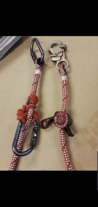

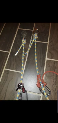

I use one and a hitch on the opposite end to create a DEDA lanyard which sounds like what your referring to but with two mechanicals. The spliced Sirius was my original build for my lanyard, after a mishap with my saw I rebuilt the same system with the drenaline.Screenshot_20191013-094418_Photos.webpScreenshot_20191013-094400_Photos.webp

I use one and a hitch on the opposite end to create a DEDA lanyard which sounds like what your referring to but with two mechanicals. The spliced Sirius was my original build for my lanyard, after a mishap with my saw I rebuilt the same system with the drenaline.View attachment 62806View attachment 62807
Jehinten,
What termination knots do you have on that DrenaLINE lanyard? They look funky in the pic.
Tony
Jehinten,
Tony
Your right, they do look a little funky. I believe I was tying a scaffold knot (it's been a little while since that pic was taken so I can't be 100% sure on my intent) but ended up tying it like a traditional hangman's knot but with less wraps. In the picture it hadn't been set hard yet which makes them look funky, it's nice and tight now.
Great! As the knot master Clifford Ashley so aptly said ( paraphrasing here) “ A knot is either tied exactly correct or terribly wrong”
You would be surprised how often I see the grapvine/scaffold/ fisherman’s tied wrong as a termination knot.
How we do anything is how we do everything. Cannot escape it and thanks for checking and correcting.
