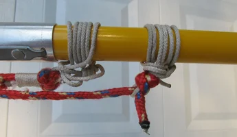

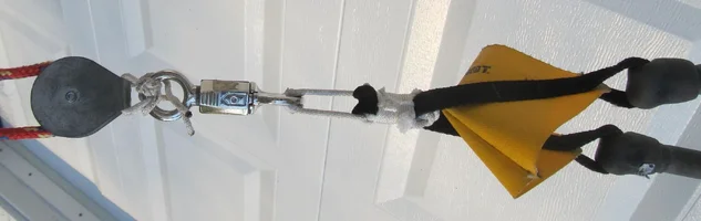

I've really enjoyed using my Big Shot line launcher after making some modifications. I wasn't strong enough to hold tension and aim very well at the same time, so I made a 2:1 pulley arrangement with a prussik on the end of both legs. In order to get enough tension for long shots, I had to shorten the strap on the cup. I added a trigger using an inexpensive panic snap usually used for dog leashes.
I've been using it like this for several months with no problems.
To cock it, I hold the pole vertically between my elbow and side of my body. I push the lower prussik all the way down, and the second one far enough to get the required tension for the shot. I'm always careful to keep both hands below the trigger while aiming and releasing the shot.
