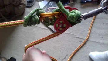

@JontreeHI, there might be binding due to the legs being too short to allow the ring to be positioned farther down from the wraps. Another possibility is the rope you’re using. Looking at your pictures it looks like it flattens easily, I’ve only used HTP, perhaps that makes a difference. Maybe try one less wrap to get more leg length to get more adjustment.
@climbstihl, the binding while tending has happened to me. I’ve found that when it first starts to bind, stop pulling and then the second attempt at tending will make it slide easily.

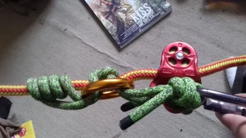

Since I always use it above the hitchclimber, I've found the orientation of the ring is also important when tending.
The first picture shows how I tie it, although sometimes it is tighter than that, the second picture shows the correct position of the fing for tending. If the twists behind the ring are offset a little bit, the ring can go off to the side, inhibiting tending. I use a 45mm ring with 10mm courant phoenix, the rope is a 12mm.20190417_164557.webp20190417_164700.webp
It looks like with the longer legs and using the bottom hole of the HC, it causes the pulley to rotate until the sheave contacts the twist, and then it starts to push the hitch. Maybe try the top hole with slightly shorter legs. This might make the HC push up on the ring, which in turn would push on the wraps.
Maybe even try it without the HC, using shorter legs?

Hey Jon, if it binds, the ring is too close to the wraps. The legs of the cord you’re using might not be long enough to add slack to the upper part of the hitch. The 6 wrap Prusik in the other thread bites very hard by itself. With the twist and ring added, and long enough legs, the ring can be positioned far enough away from the wraps, that it wouldn’t bite. Another possibility is if you’re using a braid instead of a twist in the back. If the legs get longer as you’re using it, the bottom part of the hitch isn’t locking up, and the wraps slip past the ring, and would tighten, and eventually bind up.
@evo, the small rings will work as long as three sections of the hitch cord, and the second eye will fit through. I’m not sure if a really large cord in a small ring would allow the twist to make contact with the rope, or if it’s necessary that it does. The bottom part should prevent the wraps from tightening. You don’t want too big of a ring, or the twist will spread out too far, and cause the wraps to tighten.
