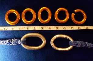

here is a scary picture...... not all of the rings that were tested failed so low, but the inconsistancy is the scary part

Just 3 of us that work at Poteet Tree Service. We are developing some innovative products and want to hold and document thoroughly field trials prior to letting others use them. We felt that it was our responsibility to insure the products we are making meet or exceed industry standards. We have gathered as much data on these failures including video of the break tests that we have sent to the manufacturer and Rich. A big thank you to Rich and Lanphear Supply for acting quickly and professionally.

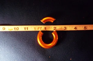

Thank you, Poteet crew. I'm not crazy after all. I wonder if my ring would have failed at 1800# pull?!
As it turns out were on to something serious with your broken aluminum ring. Good find! Way to go Rob and Rich H. with the follow up testing. Lives are at risk.
One broke at 1800# also. And for the record 3 didn't break, we stopped at 6000 and 7000.
Interesting, the ones I tested were professionally done, all tested out above 10k. You tested 5 rings total?Who is the manafacturer? heres my tests.
Still don't think we can say all aluminum is bad, maybe a bad batch. Were they pulled slowly or shock loaded?

Testing on a hydraulic machine doesn't mean squat if the rings tested are not from the same source as the photos of the failed rings. Also note not all of the rings are failing.
After two members have posted photos of what looks like failed rings from the same manufacturer it may be a good time to stop drilling the testers and instead look at the rings.
The information I received showed that only the 28 mm gold rings broke. The 46 mm silver looking ones apparently tested out fine. I only sent down one of the 28 mm rings in silver so I don't know if that one was tested.
