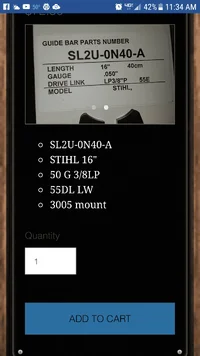

No. It's fine. I haven't used it in years and can't as I have soubl spliced eyes on every rope I have. Jack hasn't even climbed yet so it's not like I'll keep it for him. He's years away from it. I just kept it because I love it. I'll do the deal. That bar is a sexy beast.
I'll order it tonight. Do you want me to have them ship it directly to you? I think I still have your info in an old conversation

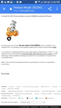

You can tell the version just from looking at them. First version (the one that all units were recalled) was for the connection point, the V2 ones fixed that with the beefed up body and swivel. Shouldn't be any V1 units around, but you never know. They looked considerably different. The V3 ones addressed the fractures/cracks in the top set of links, and have noticeably beefed up links. You can see the difference in this pic of a V2 and V3 side by side. Arrows point to the problem area, note that V3 has more metal between the outer edge and the hole where a small pin goes through the links. The V3 is on the left, V2 on the right.
You can have a V2 replaced by Petzl with a V3 if it develops hairline fractures. They only ask for the serial number and your shipping address. They don't care who bought it or where, only if it was sold new within the last 3 years (the warranty period). They pay for the shipping both directions.
