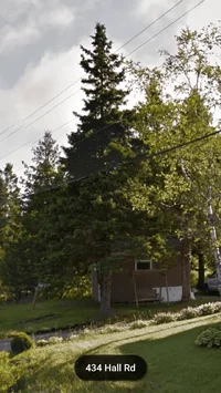

If you don't feel comfortable I wouldn't attempt it. I have done some pretty sketchy things, and still do upon occasion. I don't mess around with electricity. Very often you don't get a second chance. Do you have a picture?
IMG_0754.webp Didn't take a picture but just stole this one off google earth, not the best but gives you an idea...like I said the stem would be close to 10 feet away. I don't have the line clearence course but I would like to get the certification sooner than later so I get a better understanding of power lines and such, just passed the arborist exam a few months back.
View attachment 42807 Didn't take a picture but just stole this one off google earth, not the best but gives you an idea...like I said the stem would be close to 10 feet away. I don't have the line clearence course but I would like to get the certification sooner than later so I get a better understanding of power lines and such, just passed the arborist exam a few months back.
I would do that tree based on the pictures. I know my skill set and I would be cautious but not overly worried. The limbs are small and easy to control. But, I would suggest that if you can not stay 10 feet away, which includes you and any limbs you cut..etc. You should think about passing on it.
Yeah like you said the limbs are small especially at the level of the lines and above, easily managed. Pretty sure I'll be alright just wanted to get a few opinions. Thanks.
