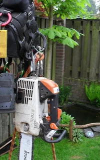

Big caritool upside down trough the 2 slings on the side off the TM. Works great and not much problems with it catching branches or whatever. The big caritool won't break even with a MS880 in it ;-)
see pic
climb safe
wouter

It's a lot easier to click in the chainsaw using it upside down. Just add a climbing carabiner to the chainsaw and pul it up against the wired gate and it will flip right in.
Other thing is branches won't get as easy caugt in this position.
climb safe
wouter
