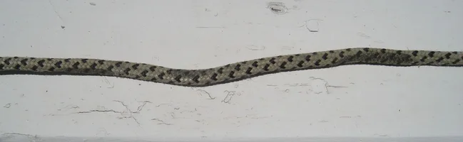

I also noticed significant wear to my split tail after just one tree... anyone else notice that?

A few years back I played with using a french link as a quick release for a VT/bachmann style knot. it didnt work that well, now that I see how he has integrated the ring into the prusik it has brought new life to the Idea of a faster running knot with less heat. but now that ive started playing with this style it seems to transfer alot of heat directly to my split tail, I think it still needs work but some experimentation just might pay off. Im definitely going to keep playing with the idea. and some more imput would be great, especially where to get thin strong heat resistant cordage in the 7mm range. I think that is the key to this style of friction hitch, the stuff i have is spectra type which is no good, but some 7mm ultra tech would be great. anyone know where to get some?
here is that pic again of my split tail after working just one tree with this style hitch
Is that melting? Or is it glazing from dirt? To me it just looks like a drit glaze. As you can see it's a cool knot only 3 parts of rope touch the rest is the ring.
