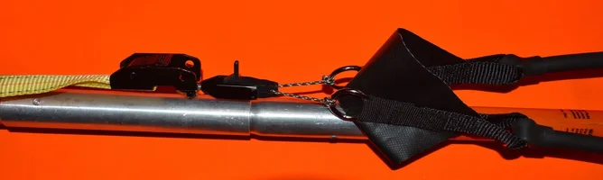

I added an archery trigger and adjustable strap to my Big Shot, but all I did was tie a loop from some starter cord, and girth hitched that loop to the BS strap in which one would normally hold with their fingers.

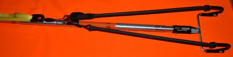

I thought the design of the Tekichu would allow the tubing to come off the hooks frequently. I can't understand their thinking that this would be an OK thing.

Little piece of double sided tape would probably keep them in place and still allow for easy removal.

Seems annoying to have the bands popping off. I do hate changing bands on the big shot though, so I guess I'll have to weigh those two.

It is always, as we know, personal choice and how each climber uses things. Maybe the weaker bands and the wider grip on the handle will make it more comfortable with adequate distance for many. I always use the "tie down" and triger and get the mechanical advantage with capture, hold it like a shot gun, so the grip etc. means nothing to me.

:oops:What about making a "universal" pouch and using BS rubber? All it would take is to make some plugs the same diameter as the big shot head or the Tekichu balls.. (yes I know....:oops:)
I'm very happy with the performance and accuracy of the new Tekichu. I haven't had any issues with the rubber flying out of place.
