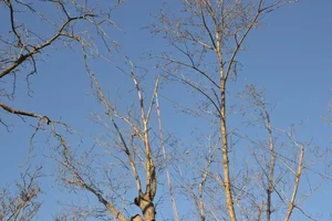

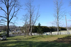

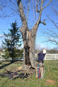

There was no way I was going to climb this silver maple. Fortunately to the left was a huge walnut, and a medium sized elm on the right. It takes a little more creativity, and a little more work when you don't have a bucket truck.
I didn't rig any of the tree (probably wouldn't have tolerated much to begin with), just chunked down small sections until the trunk would fit inside the fence. 068 copy.webp 061 copy.webp 072 copy.webp
Yep, that one looks sketchy. I swear in pic #1 it looks like you're tied into a utility line. I'm guessing that's your remote TIP, on a line spanning between the other two trees?
Yea--it's actually a 5/8 bull line. Had to stretch it as tight as possible to get the height I needed.

Nice. Looked like the tree held up to the rigging pretty well in spite of its questionable stability.

We used 1/2" PMI easybend static kernmantle rope for the highline as that is the longest rope I have (500') -although we used about half. We tensioned it as you mentioned. Anchored one end and used 3:1 MA to tighten the slack.

Used a butterfly in this instance. Main reason was, the anchor point in the walnut was a good ten feet higher than the one in the elm. This was due to available sufficient limb junctures in two trees of significantly different maturity levels. Gotta use good strong anchor points when using this system because there is so much ma if your 165lbs shock loads the TIP due to a fall.
Floating is nice on many occasions, but in this instance, it would have acted more like a zipline if I had come off the maple. Needed the height advantage of the walnut anchor point in order to achieve the climb height I needed in the maple.
Squad makes a good point; a floating anchor keeps the TIP closer overhead. Another reason that this stationary TIP worked on this occasion was that all the work took place close to the trunk, ie. I was never at a great angle from the TIP--hope that makes sense.
