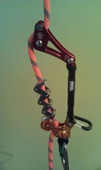

I thought someone posted a picture of a cool way to stream line the m method with the zig zag . If anyone knows where I could find that picture for a co-worker , that would be awesome...
It was Tony. Follow me here...
Place a Petzl fixie pulley (others may work?) over your climb line and put the pulley over the upper eye of the ZZ by straddling the eye with the two side plates. Capture the pulley and the upper eye with a single oval biner and rotate the biner gate up. Put your eye splice onto the biner and off you go. Hope it makes sense!
I just use one of the soft dog bones on bottom
The rock climbers anchor clips with two carabiners and strap I just remove the accessory carabiners put pulley like the fix in the pic works great with pulleys aver
