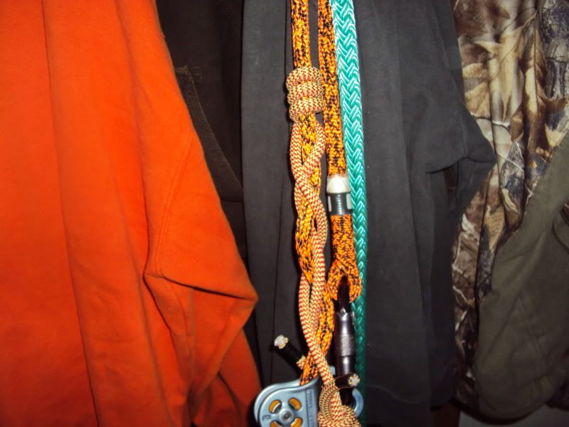

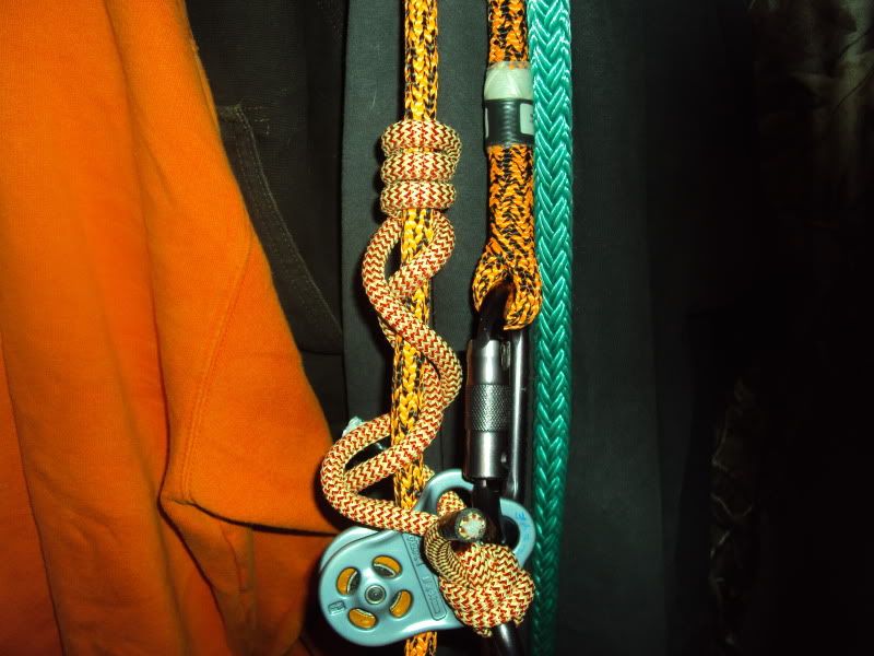

Ok I made up a longer piece of cord as of right now its about 32" eye to eye. Heres what I came up with only issue I can see is that 4 wrap 2 braid turns into a 3 wrap 3 braid with about 2 mins of use. I climbed on it tonight at about head height and it seems to grab fairly well and runs nicely while tending slack. Here are some pics, Any opinions? I shortened it a little and it was imediately really grabby tending my slack. I ordered some 10mm OP tonight to try out as well its cheap enough I figured I might as well see if it helps. This rope needs a harder hitch cord I tried HRC and beeline and they were much worse then the OP any suggestions on another cord type?
Edit: The pics show the hitch after tending slack a few times you can see now how it unravels into the 3 wrap 3 braid configuration.

I usually have the opposite problem my 4 wrap 2 braid vt turns into a 5 wrap 1 braid so I usually tie it with 4 wraps the adjust it to 5 and it works great. Good luck man I went through the same problem and it took me a while to find what worked for me
Yeah I had that problem with the hitch climber and a shorter cord before the splice was grabing a braid and turning it into a wrap. I like this configuration. I shortend it again and same problem the knot doesnt run as well and is too grabby when tending slack. I am going to try the 10mm and see how that is when I get it. The issue with mine is when I load it the first time it drops the wrap and turns it into a braid. After that it stays as a 3 and 3 conversion without movement.
cthompson22 looks like you are using a valdotain (top leg always stays on top for braids). I found a valdotain tresse (alternating leg on top of each braid) made mine less likely to turn a wrap into a braid or vice versa.

I originally tried that configuration the only thing I didnt like it the hitch seemed to twist and drop the bottom braid all of the time. I couldnt keep it together. Someone told me to try it this way and it a non issue of falling apart after that. By the way I wish I was that weight it would make my life alot easier. 180 is no fun.
