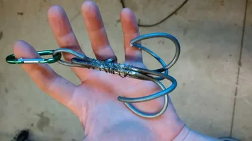

Grapnel:
Here is a copy of a popular grapnel made from No. 9 fencing wire. I wrapped it in picture wire from the dollar store and hit it with plumbing solder (add flux, heat with torch, apply solder), ground off any sharp edges and taped it up. Took me a good half hour but it works great. Could maybe use some lead to give it more weight but works as-is. Total Cost: $0

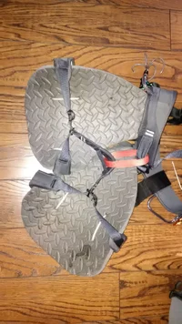

Harnness Mods:
I climb on a modified rock climbing harness. Before any modifications, it was quite uncomfortable to climb in as-is, so I copied the style of some of the commercial tree harnesses to distribute the weight better. I did not modify or stitch to the original saddle in any way, I simply added to it, thinking that this wouldn't impact its safety performance. My harness is a black diamond momentum, which costs $54 and is much cheaper than a tree climbing harness.
I got some material from an old fall-arrest harness that came with a tree stand (for deer hunting). Most tree stands come with a harness - I think I have 4 or 5 in total so I sacrificed an older one. I took a strap that had a length adjuster in it and wrapped the adjustment loop around the leg strap. I sewed the other end in a loop around the waist strap. This helps distribute some weight to the hips.
Next, I took some foam padding (the kind you put down for cushioning under the feet at the work bench) and cut it into a teardrop shape. I secured it to the inside of the leg loops with zip ties. I got the idea for this material from someone else's homemade harness thread but can't remember where I saw it. I had some extra lying around.
Total cost: $61.02 CAD after tax

Grapnel:

Harnness Mods:
