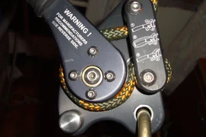

I acquired a number of these AS AUTO STOP LOWERING DEVICES, they were originally from Australia.
They were made 2006/08 by a company called 'Fallright', and were part of a rescue kit.
30kn swl and capable of lowering 400kgs.
Hope someone can help with a price guide that these sold for?

So tom you think they have no value? as a descent device, lowering yourself 100ft into a potholing pit it would be an easy and very safe thing to do.
I believe its got rescue applications for tree surgery.
Its a very solid, bomb proof piece of kit, unlike petzl stuff....

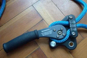

What's then bend radius - it traps the rope in places, dr.storrick has a good explanation.
yes -Do you biner into the small hole on the bottom I assume
pull it down, its in the locked position in photo below -Do you push or pull the handle
its very easy, based on the handle length and fulcrum -Is it hard to release after a slip or you bounce into it
anyones poison -Srt, ddrt, ...
not yet -Do you have any you tube video?
yes, but with great control, could be used for lowering timber in controlled setup -Is it just for decent, like a figure 8, so you need more hardware to ascend
no idea, cannot find any links -What do they retail for down under
Dr.Storrick link... http://storrick.cnc.net/VerticalDevicesPage/Rappel/PolyBollardPages/PolyBollard1003.html

in this pic does the rope get bent and squeezed or are there teeth or what is the actual rope holding mechanism? an demo vid would help
I've got several other bollard type descenders already. The only time that I've ever used them was when I was in tall West Coast trees. They dissipate heat really well. A couple of them have 'panic' stops that will lock if the handle is either let go or grabbed tight. Kind of like the action on a Petzl I'd.
They have value...but not much to me. $15 w/shipping :)
There are no teeth, just bent and squeezed..will do a video shortly.
