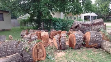

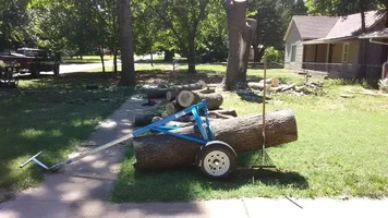

Yeah, I should have subbed on these two. I had a large elm and a large maple removal within a week of each other. That's when I really started thinking, "Hey, I could use an extra hand here." lol

Looking at those pictures, you got a choice that needs to happen soon. Especially if that's going to be the norm. You either need to turn that stuff down or grow. Your body ain't gonna hold up to that sort of punishment. Try renting a mini skid for a week or two on jobs like that. Around here a machine that lifts just short of 2k is 450 a week. Sure, you probably won't be able to get a grapple (depending on the yard) but forks are better than your back.
You rent one a few times you won't be thinking about WC for a few more months, you will be thinking about financing. And interest is a heck of a lot cheaper than WC.

A walk behind unit is what you are looking for in a mini (what May yards call them). Most have a ride on platform built in except maybe that toro (it's an option they may not have gotten). But I think I saw they deal with ditch witch too so you might get lucky. Even if you have to walk behind it it's better than pushing that log on by hand... and you will still have steam left at the end of the day.
You're rolling logs with the arch, so that's a good move. A mini with that arch will do a lot.
You can buy a grapple, for the mini rent. You will eventually get a mini, unless you end up going for a small articulated loader.
