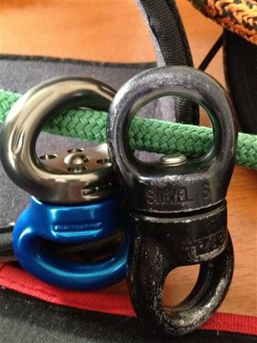

One thing I really like over the petzl small swivel is that the opposite side is rope bridge friendly. Here's a picture where you can see the difference in the way the center pin is rounded.
The only downside of the dmm is that the small swivel will not pass a the throat of an eye splice easily, if at all. My tachyon and imori both get hung up heavily on the whipping. This is only a bummer if you use the O method.
