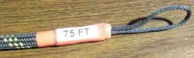

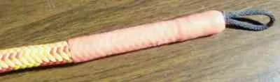

I just cut about 2" ~ 3" of the core out (or most of it) and use a Speedy Stitcher to sew a short length of cord or webbing inside the cover, formed into a loop. It's strong enough that I pull saws up into the tree with it, sometimes.
Most of my ropes, but not all, need to fit through a ZigZag, so on those ones I have to make sure that it fits... otherwise, I don't worry about it.
Looks clean, Jeff! Does the loop ever get caught on branches? My first version was a hole melted through the tail with some throwline in a loop. It didn't feed through my runner that smoothly (the line would fold back and cause some resistance) so I opted for a larger hole melted in the tail that would fit the bight of my retrieval ball.
I've never snagged the loop on anything. I tried melting a hole through the rope with a soldering pencil, and like you said, when you fold the loop of cord over the end, it's too big to fit through the ZigZag, so I switched to this method. Usually, I just do it right off the bat when I buy a hank of rope.

I like that. I’ve done something similar (though more crude) for my main rigging line. It has a plastic tube formed to a horseshoe, with throwline through it and sewn into the end of my line. It’s great for clipping to my saddle when climbing out to the next rig, and hauling up a saw.

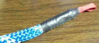

Ive got a little "accessory" eye in my km max. Pulled a few inches of core, folded it over right with just enough room for an xsre to fit thru and stitched it up with wipping twine with a bit of heat shrink to finish it off. Easy to do and plenty strong enough to pull even big saws up. Makes setting a line thru tight crotches a breeze as well. I make the eye small enough that a normal carabiner cannot fit as to never get confused as life support.
