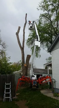

Will the outriggers deploy on a slope? I deal with a lot of steep driveways.

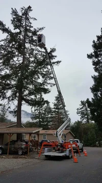

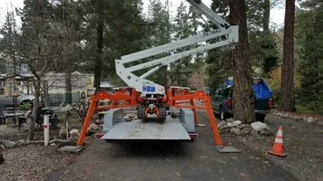

Absolutely. The amplitude offered by the linkage in the outrigger gives you the opportunity to setup in a slope, as well as on top of trailer/truck. A few images to give an idea, provided by actual owners.
