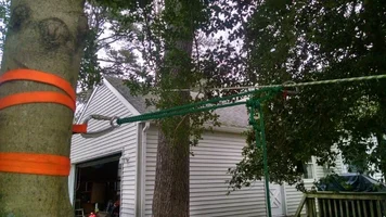

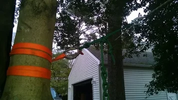

I was very indescricptive with my op . I have a whole slew of the nylon loops like your talking about Tom. Use them frequently and I get what your saying about the adjustment process I think..I'll choke limb then take up access if there is some with a marl then clip biner onto sppedline , have ground tension up line and its perfect 95% of the time I think . Just seem to get that bit of slack that devolps in the sling in certain setup that transfers to excess drop I'm trying to avoid and readjusting can be less than fun when the mainlines tight and you lose a bit on the sling. I've thought up a sling useing a Blake's hitch on a loop with a floating biner on the end to choke off limb . I'll take a pic and maybe someone can enlighten me on the advantages and limitations of the system . If their so kind as to do so . Thanks Tom.
14198000716250.webp something quick , I just threw together for an idea . lmk what you think. Oh yeah and it should be the other way around hitch on side your cutting duhhhh :rayos:
14198005788041.webp or would it ,?? Use your imagination dealing with this scenario . it is of course a spoof ,but I did just get a go pro for Xmas I'd like to try it . I thought about useing a prussik on a single line as well . looking for an option for and some ideas . Just wacked a good climb line some months back that was near new and I'm trying to give it a new life for some light rigging duty possible.
Clever idea.
Another way to gain some height is to rig two slings to the piece. Choke them as far apart as possible. That way when you send it flying it stays more horizontal which can gain precious height.
