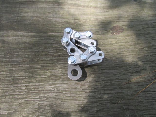

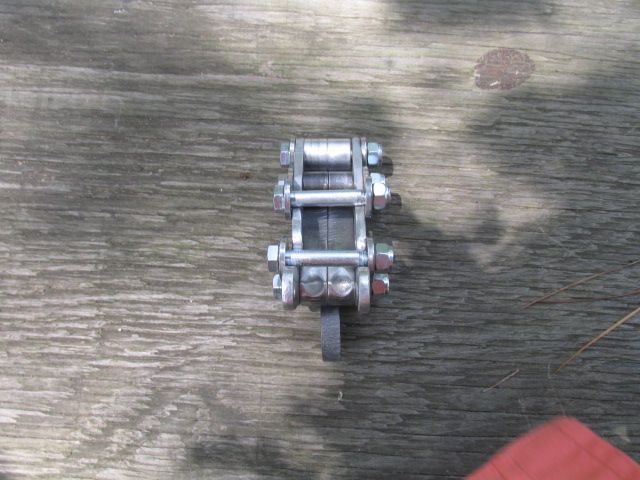

Wanna go, Johnny Pro? a full 1"wide Bulldog Bone for use with two full size ropes TRT.
Lonnie, it is quite heavy (19 oz., as shown) and you would need to thread both ropes as shown. It is possible that the friction bolts could be replaced with quick release pins, but I have none. Double wide links would also work with the side plate swivel friction links, but since this is new, I have no double strand links on hand either.
Thanks ML, I think tho if I get double strand, I will order the cottered type so that I could install the swivel friction link as in the SRT Bone.
