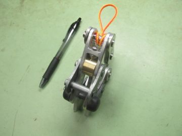

OK, I have added a swivel lock link to the upper arm of the Bulldog Bone. I also moved the swivel link 1/8" closer to the upper pivot and added a 5/8" roller (which can be swapped for a 3/4" roller or a 1/2" roller to add slightly more or less grip). here is a picture of the latest Bone in its collapsed mode, notice the size of the bone in relation to the carabiner.

I have used it both DdRT and in an O rig configuration. It is a bit tight but it does work. It also will advance as a three to one set-up on a single line.
Because of my time and expense involved, I have been considering the idea of a rent to try/own the Bulldog Bone, along with a signed disclaimer.

I have been using the Bone for the last week, and it is really fantastic. It stands up next to the rope runner. I was able to find the sweet spot for descent much faster. Hooked to a chest tether it tends just as well on ascent. And it is by far the easiest friction device of any kind (even hitches) to get on and off the rope. I have been enjoying it immensely. The size is great. I am definitely still dialing it in. But I like it just as much as my rope runner. They each have there own idiosyncrasies. We have another mechanical friction device! Thank you surveyor.

I like this design, good use of the links.I think it is much more versatile than the OAR design which basically consisted of 3 Bends. your new design has a bend followed by a progressive pinch similar to the Rope runner.
one word of caution, and this applies to your device as well as the Rope runner and to some extent others. the top control arm is quite large, if you slip or inadvertently put pressure on that top arm you go for a fast slide. as I mentioned this goes for other similar devices but the bigger that arm gets the more likely it is to happen.
