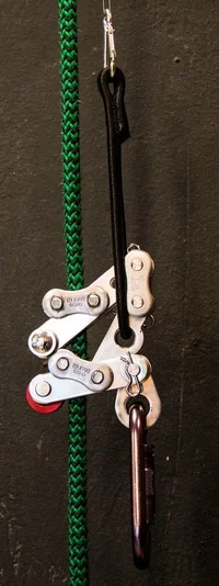

I'm still very much in the thinking stages and working out the tending. Hole in the spine vs. hole in the top arm...
Looks like I'm going to try hole in the spine with the bungee that I have sewn eyes into. In my mind the least friction tending will be in the configuration shown in this photo. The bungee can be removed after ascent or left in place with I think little impact to operation of the device.
Question: Is the top arm hole favored because it keeps the link engaged? Most other mechanical devices' have some sort of spring to initiate engagement of friction, (Unicender, Rope Runner, ZigZag, rope grabs with a cable, even the RW with a rubber ring on the tether) Seems I have read a lot about minimizing friction on the ascent.
Note: Hairpins are temporary.

I clip right into the spine w/o issue. I think the top arm tending point started from someone getting a lot of drag on ascent, not because it wasn't engaging.
Yoyoman,
It was found that the top tether provided for smoother slack tending alhough this isn't universal accepted.
Also, if you do use the top tending spot you need to be aware of the potential for slipping when force is applied by pulling back on the tether.
