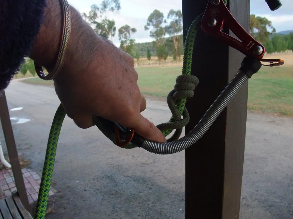

ZK2 wrench tether v4
Thanks E,, I am sure a pic will follow for good measure...I think I gotcha...
I made the tether with 4 or 5 hog rings on each eye, alternating the orientation as I worked away from the eye. I covered it all with electrical tape a shrink tubing to finish.

I made this last night and posted a short vid this in the FB SRJ forum here's the you tube link for those that may not get over there. Also a few pics.
Flex Tether Link
That looks like a very good idea. It looks like it could even be a few inches shorter. I like the way it bows slightly when tending slack, which might work to your advantage to release the hitch on the upstroke.

Did you find it led to a stiff enough tether? I tried doing more or less the same thing and the flex seemed a little high still, versus the (if something so new can be called traditional) tradition sewn tethers. Maybe you went about it smarter than I did :)
The rigidity came from the 24 strand jacket, electrical tape, and 3 layers of shrink wrap that went on after forming inner rope section out of 5mm Maxim tech cord. The hog-rings only serve as a means of joining the Maxim cord in a compact manner.
This is a "no stitch" tether, experimenting with the length, this is an extreme short version at 7.5" e-2-e. The eyes are as long as the entire tether, then taped with vinyl tape, then two layers of adhesive shrink tube. Appears to be very strong, I'll test to verify. Without stitching the production time is reduced dramatically.

Cool, I've been thinking about a slic pin attachment to the HC. I think you need the wrench to pivot down to horizontal at least so the rope will drop through it easily during ascent. It doesn't seem to release the hitch though when it contacts in the horizontal position, once the hitch sets the wrench goes up like it's supposed to do.
Weather convinced me not to test outdoors today. I did some limited tests on my indoor anchor. It works but I think I want the tether an inch longer for the minimum shorty. That's for a Hitch Climber, I tried it with a Micropulley and it was damn near perfect, probably excellent with a Pinto or one of the fixe type pulleys, I have neither to test.
Nice thing about a normal length tether is you can go to a different hitch or cordage when you want to. It seems like hitchs and cords behave differently on different days, different trees.
